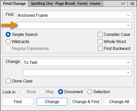

Hi FrameMaker Friends:
I'm trying to help a client locate all occurrences of a specific image and delete it. Here's what I've tried so far:
  1. If we assign an object style to the ones we are looking for (it's the same image used in multiple places, removed after each round of edits), Fm can use Find/Change to locate and select a frame based on the object style name, but won't delete it.
  2. Fm can use Find/Change to locate all anchored frames and remove them but it's all of them.
So, how is the text field used for an anchored frame search? Is there something I can type in there that will allow me to narrow the scope? I tried filename and full path with filename, neither worked. Any other ideas?

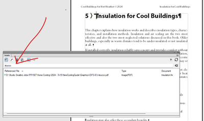

I think I would generate a list of references with referenced graphics. Search in the list for the file name and use the generated hyperlink to jump to the relevant image.
OR use the search field in the insets panel. More cumbersome, though, but doable. probly

Can you elaborate on "OR use the search field in the insets panel.", Bjorn?
~Barb
Feb 26, 2024 Feb 26, 2024
You can search for specific file names in the "Insets Panel". It will require  you to open all chapters, though, which is why this is a more time consuming effort. A generated list is to be preferred I think. OR merely rename the graphics file and open all chapters. Everywhere there is a red cross in the Insets Panel, is where the file is and can be located by clicking. But it will - again - require opening all chapters.
Bjørn Smalbro - FrameMaker.dk
Thank you, all of you! Love this forum. I'll play with both tonight so that I can show the client in the morning.
~Barb

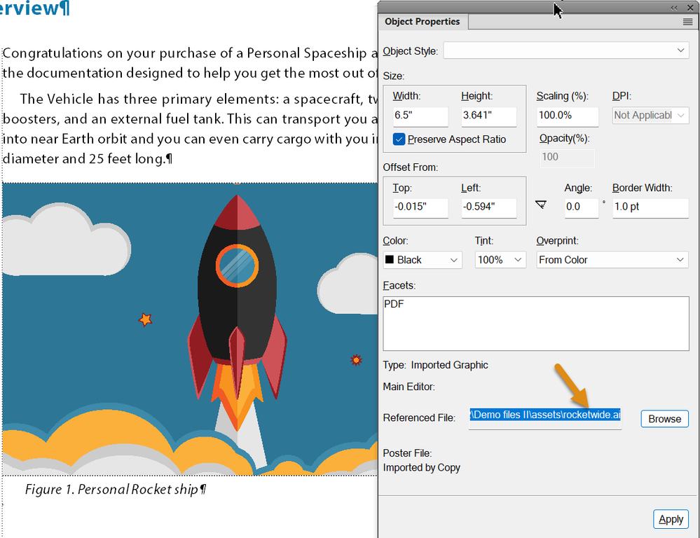

OK, Rick. I finally had time to sit down to work through this but am still doing something wrong.
This is the file I am testing with: rocketwide.ai.
I copied your code to Notepad, modified the one regex line, saved it in the startup folder, can see it, can run it but nothing ?happens. Is it the encoding when I saved the Notepad file? Or do I need to reference the entire path?
~Barb

Mar 07, 2024 Mar 07, 2024
Hi Barb, I am so sorry for the delay and for posting a broken script! I tried the script and found some errors being written to the Console. Here is the updated, working version. Note that the script will delete the anchored frame containing the image. If you want to keep the anchored frame and just delete the image, replace this line:
aframes.push (parent);
with this:
aframes.push (graphic);
Here is the updated script:
