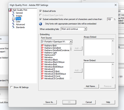

You have not described how you generate the pdf files, but an option might be that this is a Distiller issue. Distiller has these two settings:
In my experience making sure that Distiller has proper access to the relevant fonts and am able to embed them can solve a lot of font issues.
