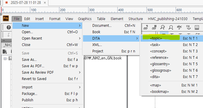

Create a new document using XML as shown below.

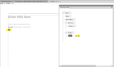

Then, insert the character using the character map.
As a result, a screen like the one below will appear

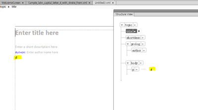

After saving and reopening the document, the screen will look like this:

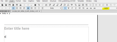

My FM is using the default font, Calibri. What's very strange is that when I input the capital D in WYSIWYG mode, it appears correctly.
When I view this in Code view, it initially appears as shown in the image below.
After saving and reopening it, the WYSIWYG view appears as shown in the image below.
In this state, the code view appears as shown in the image below.
