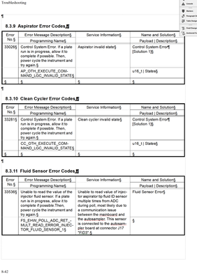

Thank you all for replying and making suggestions and/or offering to take a look at this formatting puzzle I was having. Bingo! The issue with getting the heading-level-2-and-anchored-table duo to cooperate and fall in line immediately below the heading level 1 is resolved. I believe it was a matter of setting the heading level 2 style to "Keep With: Previous Paragraph + Next Paragraph" that allowed for this. Of course, when you're confused and desparate, you grasp at anything that might possibly make a difference. So I hope that selecting both of these doesn't pose any problems in the future (like FM crashing).
If it were simply a matter of simple paragraph styles following one another, I don't think this would have been as confusing as I found it. But when one of the styles in question is anchored to a (table) frame, I wonder, could this possibly alter the rules for how styles interact with one another and flow together down the page? There are still cases where gaps between pairs of heading level 2 and anchored tables refuse to close ranks.
FM_Gap_H2_Tbl.pngā€ƒ
ā€ƒ
You can see where that small table and its header at the bottom of the images could fit easily on the page above. (By the way, you can see the table designer and paragraph designer styles for the Heading Level 2 and table in the above images.) But the small table won't fill the gap. Nevertheless, it doesn't have a problem sharing the page with a second small table and the start of another.
I suspect this has to do with some logic with the anchored frames. And that's a logic I haven't yet been able to absorb through the relatively short experience I have with FM. But I need to move on, and I suppose I can live with this for now. I'm leaving a long-winded response in case it might be of use to someone else. And I wanted to thank you all. Hugely appreciated.

Thanks again, Barb. Your video was helpful. I'm glad you included that. These tables are simply a long list of error codes and they don't need anything but cells to hold data and a heading to keep them separate and discernable in a TOC. So here's what finally worked:
1. The "Anchor" paragraph style between the heading and the table, which Winfried above suggested. I reduced the line spacing heavily for it.
2. The Heading level 2 style with "Keep With: Next Paragraph. Here I increased the line spacing above it to create a buffer with the bottom of the previous table, and I reduced the spacing to zero below it so it sits closer to the table in introduces.
3. "Start: Anywhere" for the two styles as well as the table style intself.
And that's that. Thanks so much. It's good to have people out there willing to help.
