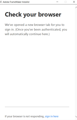

Trying to install Adobe FrameMaker 2022 but it gets stuck at below screen.
New Here ,
Jul 02, 2025 Jul 02, 2025
Tried rebooting the computer
Checked processes
Checked Windows Defender protection history
Tried re-downloading the files.
Ran it as Admin.
Opened CMD as admin and ran it as silent installation.
Nothing works.

FM is likely using whatever is the default browser on your machine (which might not be Edge). Is there anything unusual about it?

It's definitely trying to "phone home" to get you to sign in with your Adobe ID. Are you working in a corporate environment? If so, check with your IT to see if they aen't blocking some of the ports that Adobe uses to call out.
Did you try the link in the "If your browser is not responding" message?
Jul 22, 2025 Jul 22, 2025
You're not logged in. Log in at https://account.adobe.com/ using the Adobe ID you used to download the trial, and try again.
