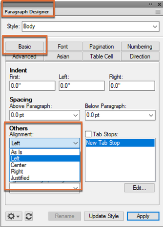

How to align texts vertically and horizontally with in a text frame?

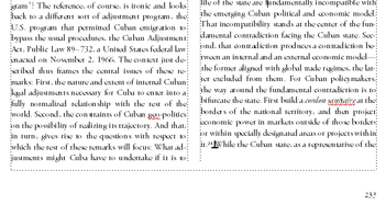

Horizontal alignment is handled via the Paragraph Designer > Basic properties on a style-by-style basis.Screen Shot 2020-09-09 at 8.15.58 AM.png
Tell us more about your vertical alignment requirements. Are you trying to center-align text vertically within a frame or are you trying to justify multiple lines within a frame, so that the first line is at the top of the frame, the last line is at the bottom and FrameMaker feathers the spacing of all the lines in between? The latter is a feature in FrameMaker using Format > Page Layout > Line Layout > Feather.
Before enabling feather:

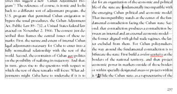

After enabling feather:

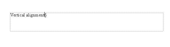

Community Beginner ,
Sep 09, 2020 Sep 09, 2020
Hi Barb,
 see the above pic. here i can control horizontal alignment by using paragrah designer but my requirement is need to align text vertically like center, bottom. in indesign it is possible so is there any way to do in framemaker??
