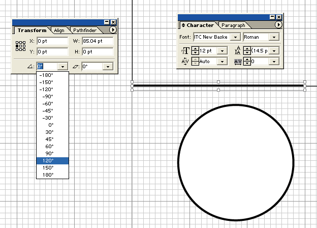

You can:
1. Create a straight path at least as long as the radius starting at 0,0;
2. Select (one of) the Reference Point(s) in the Transform Palette yielding 0,0;
3. Ctrl+C and Ctrl+F and select 120 degrees, still in the Tranform Palette;
4. Repeat 2 and 3;
5. Create the circle and move the centre to 0,0;
6. Select all, Pathfinder>Divide, and Control+Shift+G to Ungroup.
This is the Divide a Circle into Thirdendeals Thread.

Aug 30, 2008 Aug 30, 2008
I switched to points to get the GIF nice (85.04 pt corresponds to 30 mm).
