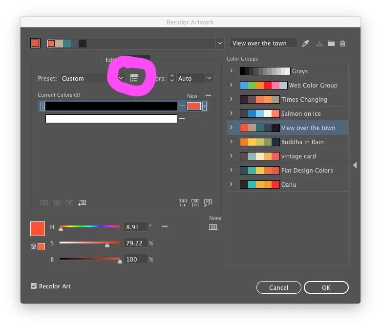

Hello everyone,
I have an all black and white vector logo and I want to change the black to another color using the Recolor Artwork tool since the logo is made up of strokes and fills. It's not doing anything when I try to use this tool.
Recolor artwork is checked on the bottom left. I've retried with a simple black square and that isn't working either.
Any advice or help is greatly appreciated. Thank you!
Correct answer Monika Gause
Click on this icon
Make sure that black is not protected from recoloring.

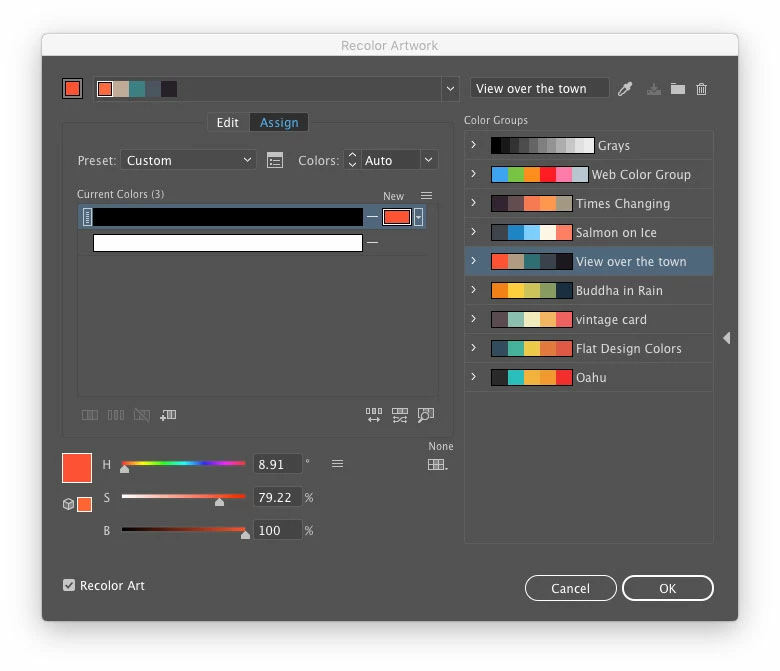

Ton Frederiks
September 27, 2018
Click on the line between the black color and the new red color to allow the black to be changed.
When you click that line it should become an arrow that points to the new color.
Monika Gause
Monika GauseCommunity ExpertCorrect answer
September 27, 2018
Click on this icon
September 27, 2018
WOW.
Thank You!
