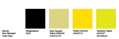

Thanks to all who have contributed to this thread! I have found it very helpful! My issue is that I am also trying to prevent the [None] and [Registration] swatches from displaying when the swatch palette is generated using RenderSwatchLegend, but I can't figure out where exactly in the script to add the commands that itsBenMason suggested above. Can someone assist by explaining exactly where and what the commands are to eliminate the [None] and [Registration] swatches? Below is a screenshot of a section of the swatches menu and a section of the palette that is generated from the script. You can see the 2 swatches I need eliminated. Thanks for any assistance!
Screen Shot 2020-05-15 at 9.32.50 PM.pngScreen Shot 2020-05-15 at 9.23.28 PM.png
May 15, 2020 May 15, 2020
Hi, I have two versions of this scripts. The following version skips [None] and [Registration]. You can try following script. May be this will help you.

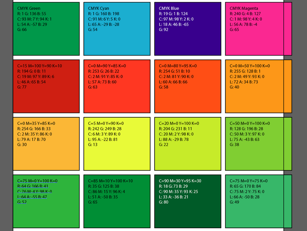

Community Beginner ,
May 18, 2020 May 18, 2020
Thanks, charu16
That helped! Any idea why, after the color Redwood Red in the legend, a new row starts instead of continuing along? I have 13 columns defined in the script.
 Screen Shot 2020-05-18 at 3.19.15 PM.png     Screen Shot 2020-05-18 at 3.16.41 PM.png
Here's what I have now:

Hi, I am not sure why only 5 are coming in first row, because this script was wriiten by someone else. But I ahve updated this version now it will have as expected columns. So, it is difficult to explain the reason behind the existing one as it was written by other writer. Please try below version
// Render Swatch Legend v1.3 -- CC
//  This script will generate a legend of rectangles for every swatch in the main swatches palette.
//  You can configure spacing and value display by configuring the variables at the top
//  of the script.
//   update: v1.1 now tests color brightness and renders a white label if the color is dark.
//   update: v1.2 uses adobe colour converter, rather than rgb colour conversion for a closer match.
//   update: v1.3 adds multiple colour space values based on array printColors.

Let us know if this helps
Best regards
Awesome! Thank you charu16 That worked! Thanks you so much!!!

As I do to eliminate the 2 blank spaces where it should not appear (none and registration) example this is what appears.
And I want it to look more like this.
Can someone make this possible please?
