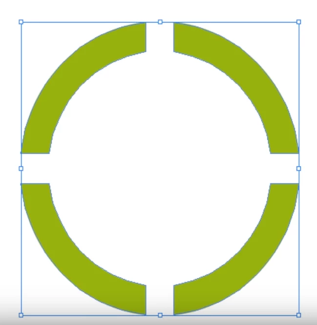

Here is the result I want:

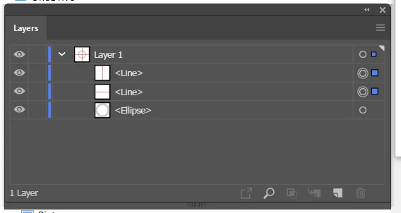

  4. Select the lines (only) cut/paste control-F so that they are in front.
  5. Group the lines (only) (using the layers panel and Group from the Object menu)

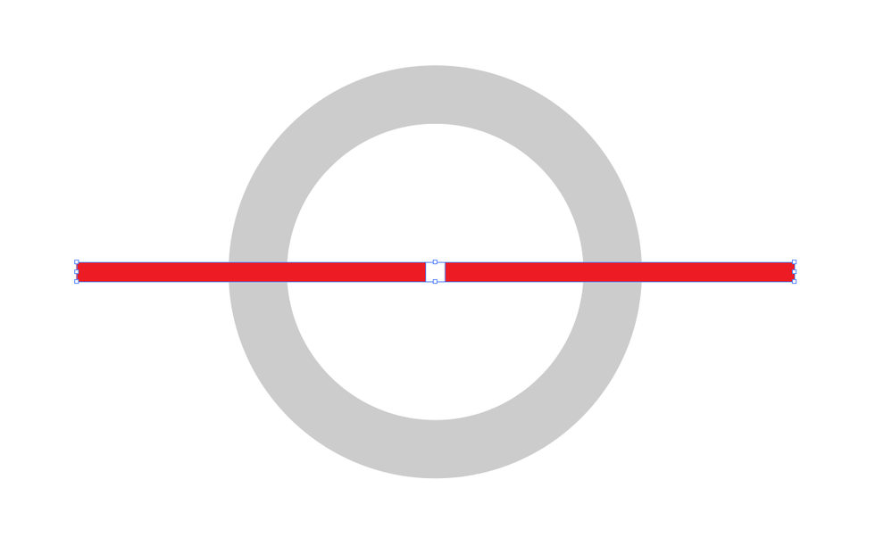

This is the result:
I have been consistent in achieving this unremarkable result several times. Obviously, I am doing something wrong. It is possible that the tutorials are for an older version of Illustrator -- I have the latest CC version, 24.02 -- and that an extra or other step is now necessary. What puzzles me is that even though the cross is grouped, when I remove front, it removes one section of the cross, and does not remove parts of the circle. Puzzled.
