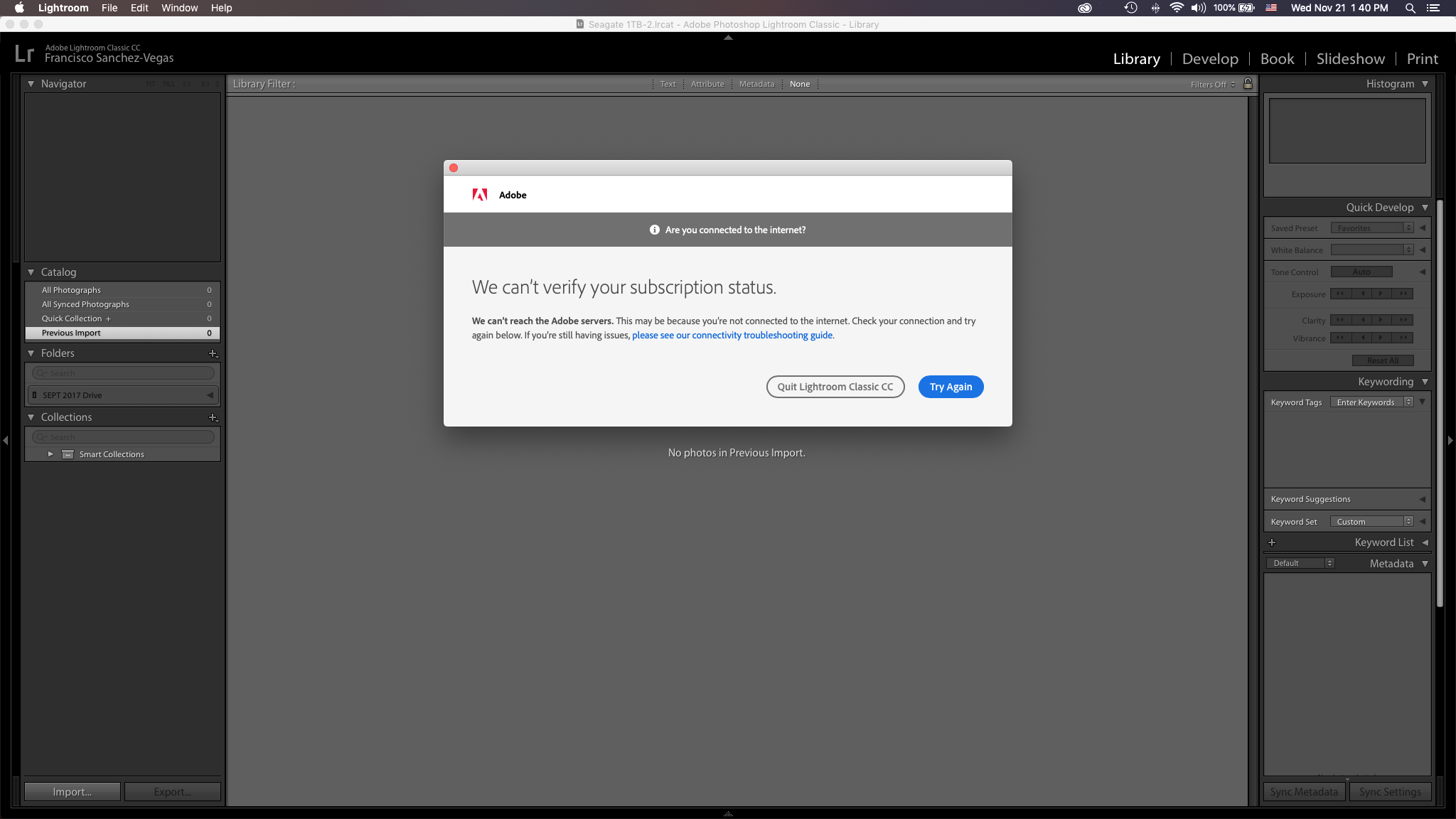

Greetings! Starting my Classic Lr CC (subscription paid) a pop-up window questions my connectivity and also states that Adobe "Can't verify subscription status... " and does NOT indicate an error number. I have no access to my app. Please note that I do have access to the internet and connectivity. How do i go about solving this issue? Thank you

Thanks for your comment. When I start Lr, the pop-up window indicated dominates the screen and will not permite me to access the "Sign In" mode. It repeats the message previously stated with the only options to "Try Again" or exit. I can start Photoshop (and automatically Sign in) as part of my subscription but NOT Lr. On an additional note, I can initiate Adobe Creative Cloud where my apps are listed. Very frustrating. FSV

My friends, first I don't know better, that's the reason I'm asking for help and which I appreciate. Moving on as it is suggested, I just uninstalled and reinstalled Lr (desktop version, i believe I mentioned earlier in this thread) directly from the ACC: same result, window pop-up. Hence connectivity and subscription seems to be ok, except that Lr wont open.

HI! Have signed out as suggested and signed back in. Also, reinstalled directly from ACC my Lr. (please note that I've yet to update Lr Cloud based app). I then tried to open directly from the drop down menu with the resulting image.
Screen Shot 2018-11-21 at 1.37.27 PM.pngScreen Shot 2018-11-21 at 1.40.01 PM.png
