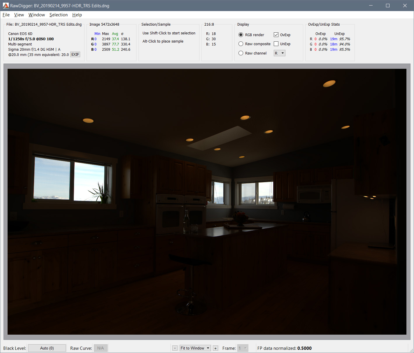

Looking at the lowest exposure BV_20190214_9958.CR2 file and HDR DNG the raw data highlights aren't clipped, but there isn't a lot of detail in the windows. Also when you paint n the windows using Auto Mask keep the Brush Size small and Feather low (0-15). Even then you'll get spill-over in areas that have similar luminance and color to the window frame. Use the ALT key Subtract to remove the spillage. There's nothing wrong here except the window frames are very close in luminance and color to the image in the windows. The Luminace and Color Range Mask don't work well here either for the same reason.
Here's what the raw data looks like now in RawDigger with you're current bracketed files. You probably need to reshoot the bracket with a couple of lower exposure brackets, which may improve the detail in the windows.
