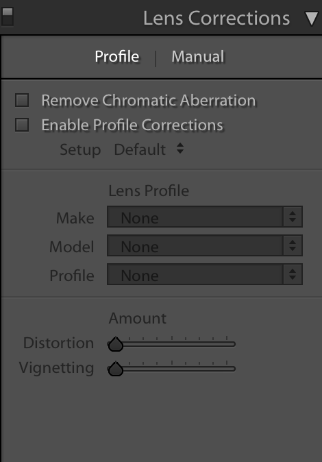

You can easily remove CA in LightRoom using Lens Corrections.  Check the box and away you go.

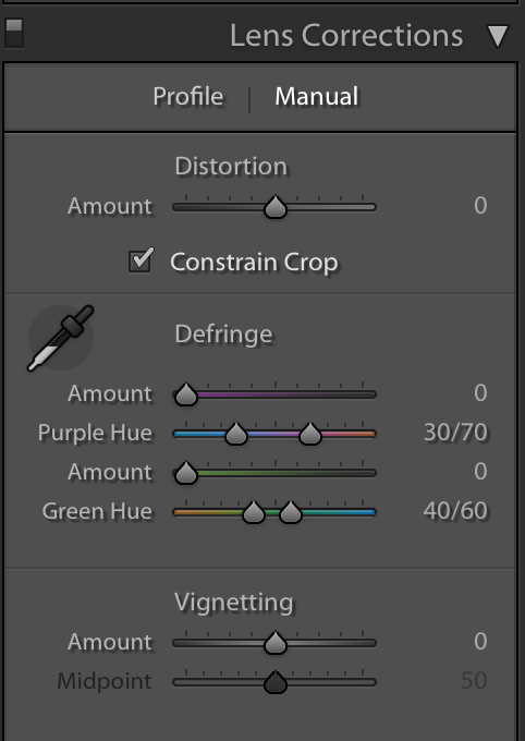

If (like me) you want to do more than automatic, use the Manual tab
Choose which CA and hue your bothered by and just fix that.

Thanks, Bob, I'm aware of this lightroom functionality. The manual mode works in a somewhat different way. And often eats needed detail. While true correction of aberrations adds sharpness to the image due to alignment of color chanels.
Anyway my request is to enhance lightroom Remove chromatic aberrations feature to work with tilt shift lenses.

Sounds like your getting CA in shift areas only.  Certainly there's no lens profile for any TS lens.  But manual corrections do work.  Just do them in the area they are needed and not as an overall move.  In this TS Lens case I'd recommend correcting what's needed and putting that together with the good portion of the image in PS.
