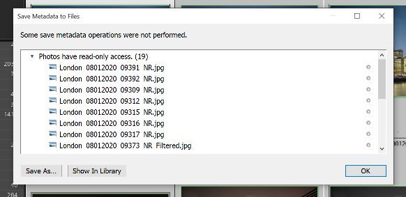

Having some issues as lightroom says files are locked, but I can't see how to unlock....
Show us a screen-clip of the error message please. Has the OS marked them as "Read Only"?

Really not sure whythe rad only access thing is kickingoff...
Screen clips as requested:

a) The 'Properties' dialog you show are for some files in your Dropbox folder. (with weird filenames?)
b) The error message for adding metadata shows files with totally different filenames.
So, where are the files that you know about in the Lightroom Catalog?
Do a filter search for one of those filenames  (that you saw in the error message) in the Calalog Library, then [Right-click] and "Go to Folder in Library". This will indicate the 'true' folder where Lr-Classic knows these files are located.
Then you can also "Show in Explorer/Finder" where you can check Read/Write permissions on the 'true' folder location.
In the final analysis- I suspect that the files you are looking at in Bridge are NOT the same files you have in the Lightroom Library. Thus transferring metadata is not possible.

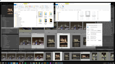

Apr 24, 2020 Apr 24, 2020
Thanks again for the feedback.
I followed the trail as suggested and am definately looking at the right files....
Still very confused
Joanne
Can we check a little further- (I love mysteries 🙂 )
Your OS File Explorer is looking at a DROPBOX folder on the D-drive-
In the Lightroom Folder panel can you [Right-Click] on the {020 Photo} topmost folder and select [Show Parent Folder]
If you are indeed looking at the same folder then you should see the {Dropbox} parent folder also appear above {020 Photo} in the Lightroom panel.
I am still not convinced you were looking at the same files.
The error message you posted shows filenames for the JPGs with Spaces. (eg. London 0812020 09381.jpg)
The File Explorer screen-clips show filenames with Underscores. (eg. London_0812020_0916.jpg)
And note: the error message says the files are "Read Only"! A good reason why you cannot write metadata to the files!
Regards. My System: Windows-11, Lightroom-Classic 14.5.1, Photoshop 26.10, ACR 17.5, Lightroom 8.5, Lr-iOS 10.4.0, Bridge 15.1.1 .
