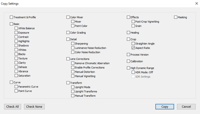

You can also copy-paste Aspect Ratio from one photo onto many others
