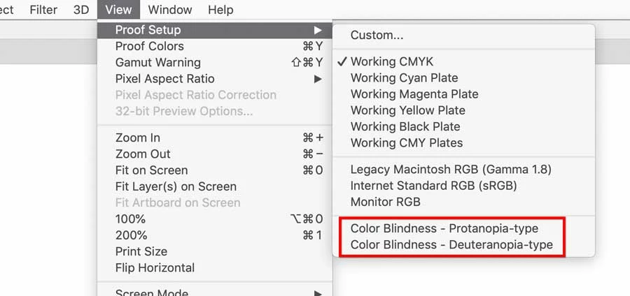

What Photoshop does have in that area are a couple of commands for previewing an image as if it was being seen by someone with color blindness. You can find this information in Photoshop Help, under Proofing Colors in Photoshop. You’ll have to determine whether it’s the right tool for what you’re trying to achieve.
