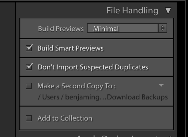

Explorer ,
Sep 09, 2018 Sep 09, 2018
its always been on minimal.
could this be the issue somehow?
perhaps its a bug in the new lightroom?

LEGEND ,
So you are using a Leica camera and it looks like that image is from 2014. I have noticed some very strange behavior with some of my Leica M8 images when Viewed (opened) in the develop module with the newer versions of LR that I don't see when viewing them in LR 5.
Some kind of change in the Default profile setting being applied. The only option I found that works to get them back to "Normal" (whatever that really is) is to use the Reset button then changed the camera profile to something that works for me. Then Updating the Default settings to apply that same camera profile to all images from the 3 serial numbers for the Leica M's I've used over the years.
EDIT:
That images is not from 2014. I was looking at the Time Stamp not the Date captured. In any event same applies as posted above.
LEGEND ,
LR 7.5 has problems with the profiles embedded in Leica DNGs: Lightroom/Camera Raw: Leica M 262 DNG Embedded Camera Profile Issue | Photoshop Family Customer Comm... . Perhaps the symptoms you're observing are related. Best to start a bug report in the official Adobe feedback forum, I think (or add to the existing one, if it looks like symptoms of the same problem).
