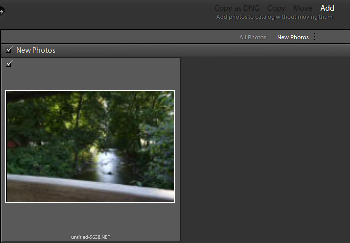

The NEF file you uploaded to DropBox shows raw-data corruption even in the library module in LR 7.5 for me on Windows, and from what you've said you've tried, the image is likely bad on the SD card since multiple methods of reimporting have not changed anything. This likely indicates a bad SD card or something amiss with the way the card was inserted. I am a little concerned by the term "MicroSD" in your screen annotations. Does the camera you're using actually have a microSD slot or are you using a microSD card in a microSD to SD converter sleeve which adds another layer or contacts that can be iffy? Or is the terminology night quite right and card just a regular SD, close to an inch in size, rather than a microSD which is smaller than half-an-inch and is the kind that goes into a smartphone?
Here is the camera-embedded thumbnail in LR's import grid before importing and it shows the entire image with the curved bridge railing along the bottom:
Neither your Library nor Develop screenshots show this railing so both are showing a corrupted image. The only difference is the Develop version shows extra multi-colored pixels while the Library image does not for you.
Here is what I see in my LR 7.5 Library preview, which definitely shows the corruption:
The bottom line is the raw data in the image is corrupted and if multiple transfers from the SD card via another card reader or via a cable connected to the camera haven't yielded an uncorrupted image, then your SD card is bad and should not be used again.
