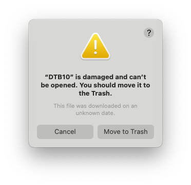

Community Beginner ,
Apr 29, 2025 Apr 29, 2025
I'm attempting to make the droplet again, just to make sure I didn't do something wroing the last few times, and now I'm getting this error.
I know the actions work - I jsut did a batch in PS, as I need these files done right now. Batch action worked great there. I really would love to solve this droplet issue. Anyone?
