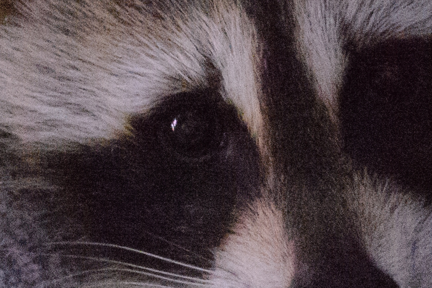

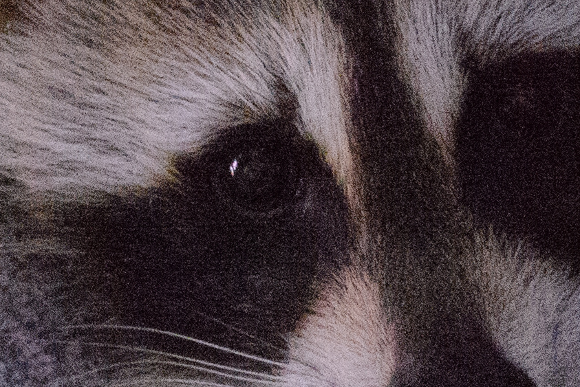

I see no difference indeed in your files. I just tried it myself and for me NR clearly gets applied upon export. Not clear what the difference is. Note that luminance at 20 is not high at all. It will usually only have a subtle effect and will spend on the other two sliders whether it will have effect at all. Can you export these images with Lightroom set to export all metadata? There are no settings included in the files at all.
Here is what I get upon export. This is an ISO 25600 file. Everything at default except for the NR luminance setting and the extreme crop.
NR 0:
NR 20:
NR 40:
Clearly luminance noise reduction gets applied upon export on my installation. You can also see that from the file sizes of the jpeg file as the more noisy, the larger the file when using jpeg compression:
NR 0: 419 kB
NR 20: 374 kB
NR 40: 338 kB

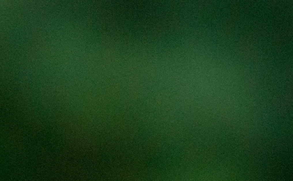

And we are also under no obligation to believe you or Turk or anyone.  This is not a jury trial where a something is deemed true when 12 or a majority of 12 people agrees with you, nor is this a group of friends or a support group where people decide to agree with you to make you feel good because they like you or care about you, right?  This is about a potential issue with a computer program where a computer program will produce the same output given the same inputs, and we're asking for inputs, not just your view of the output.
The two green JPGs posted have camera settings embedded in them but no camera-raw settings embedded in them so what settings were used cannot be deduced from the attached JPGs other than they were processed with LR 5.5, apparently.  The uncropped exported TIFs might have this information but the JPGs do not.
I have tried camera raw files from various cameras including the 70D and I have never seen NR not applied for my exports, so this is not a wide-spread bug, that affects all files or all files from a particular camera.  Maybe there was something quirky with either the telescope JPGs or the green raw files, but without those there is no evidence of anyone to test.
Because the previous recent discussion with the telescope images seemed to be about possible problems starting with JPGs I decided to try things starting with the NO-NR green jpg.  I imported that into LR, applied Lum NR 50 and this NR setting does appear to be applied to the exported which I reimported into LR and displayed side-by-side at 1:1 zoom so differences in zoom and previewer app didn't enter into what is seen:
For anyone who wants to examine the exported JPG displayed at the right, above, here it is, and you'll be able to examine the metadata and see Luminance Smoothing is 50:

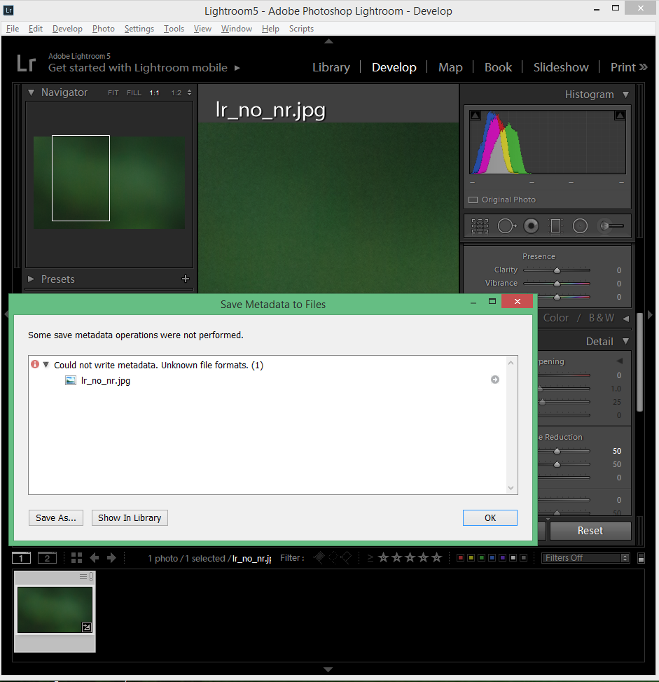

Edited:  Something appears off with the lr_no_nr.jpg included in the message, above, in that LR cannot write metadata to the JPG if I change settings and tell LR to.  Instead LR reports an error.  Just to be sure, I cleared my browser cache, re-downloaded the JPG from the message, removed and reimported the JPG into LR, then adjusted the LR Lum NR to 50 and clicked on the exclamation point and it would not work, reporting an Unknown File Format.
