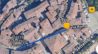

Jack said the photo was taken at Radda in Chianti. Google Street View shows the photo was taken in Radda in Chianti at coordinates 43.4871447, 11.3756591:
https://www.google.com/maps/place/53017+Radda+in+Chianti+Province+of+Siena,+Italy/@43.4871447,11.375...
(This is much different than where Jao indicated in Siena.)  The closest points in the track log to the Street View coordinates are:

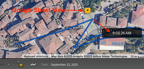

<trkpt lat="43.486721" lon="11.374245"><ele>542.238647</ele><time>2025-09-22T07:57:25Z</time></trkpt>
<trkpt lat="43.486721" lon="11.374245"><ele>542.238647</ele><time>2025-09-22T08:01:26Z</time></trkpt>
<trkpt lat="43.486919" lon="11.375193"><ele>535.415344</ele><time>2025-09-22T08:02:26Z</time></trkpt>
<trkpt lat="43.487080" lon="11.375761"><ele>542.048645</ele><time>2025-09-22T08:03:26Z</time></trkpt>
Here's LR's Map showing that portion of the track log along with coordinates provided by Google Street View:
The two times displayed in Map by hovering over the track points are in the time zone of the computer running LR, which is BST = UTC+1 in this case. They correspond to the UTC times recorded for those points in the track log, 7:57:25Z and 8:03:26Z.
Italy is in Central European Summer Time (CEST, UTC+2), so those trackpoint date/times are:
2025:09:22 9:57:25 UTC+2
2025:09:22 10:03:26 UTC+2

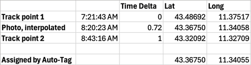

The capture time recorded in the photo is 2025:09:23 09:20:23.11 (with no time zone recorded or used by LR). It is about 23 hours and 20 minutes later than the track points (CEST).  This indicates the issue wasn't caused by setting the wrong day in the camera or picking the wrong hourly time-zone offset in the Map module.
When you invoke the Map module's Auto-Tag, it assumes the photo's capture time is in the time zone of the computer running LR.  So when you apply Auto-Tag to the photo on a computer running in BST (UTC+1) , it assumes the photo was taken 2025:09:23 08:20:23 UTC.
The two closest track points to that date/time are:
<trkpt lat="43.486916" lon="11.375174"><ele>535.536682</ele><time>2025-09-23T07:21:43Z</time></trkpt>
<trkpt lat="43.320923" lon="11.327085"><ele>333.473480</ele><time>2025-09-23T08:43:16Z</time></trkpt>
LR (and most geotagging apps) use simple linear interpolation based on the times to estimate the coordinates.  Here's an Excel table showing manually computed linear interpolation compared to the results produced by Auto-Tag -- they're nearly identical:
This demonstrates that Auto-Tag is producing the expected results for that photo and track log.
