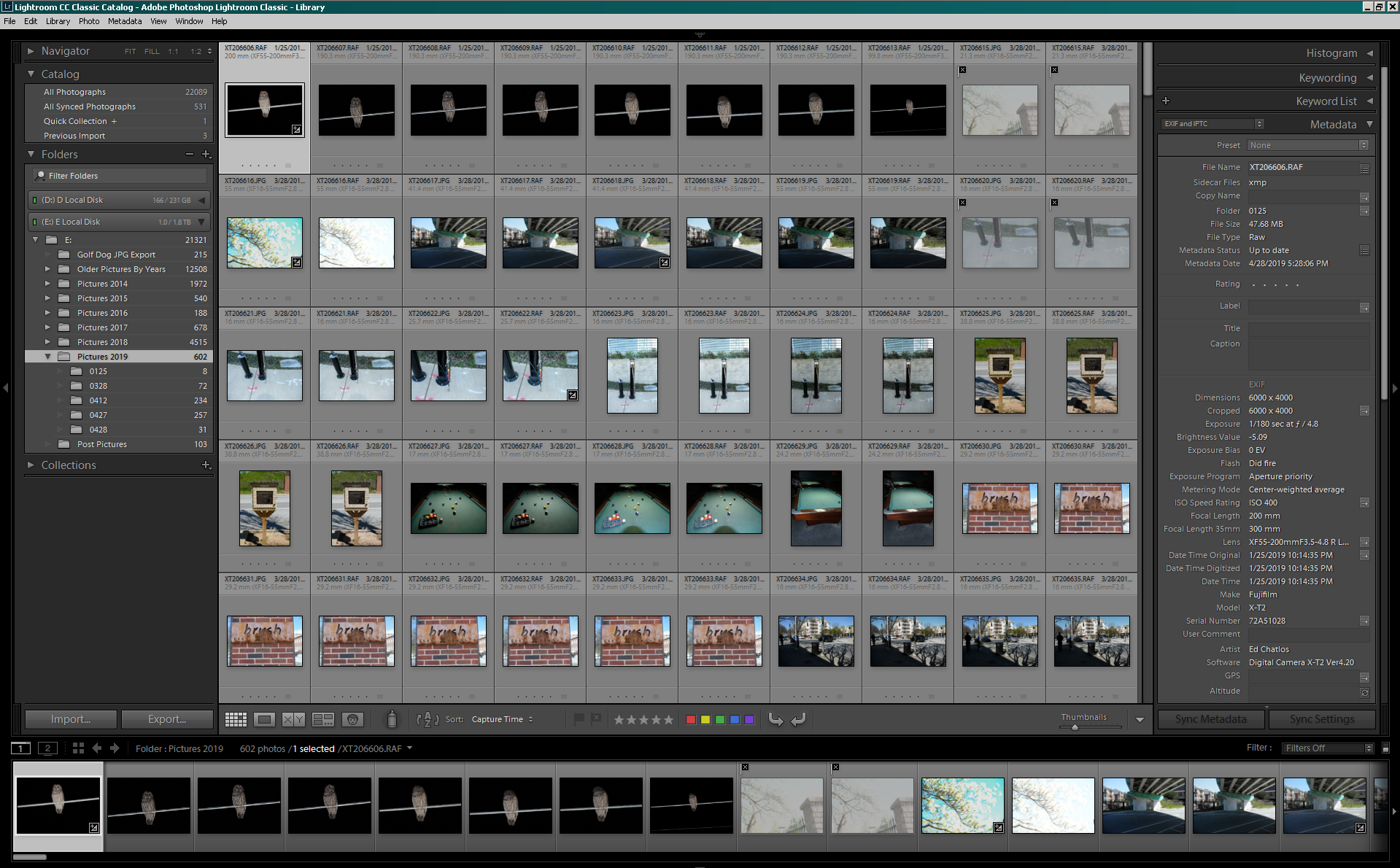

Sorry but I don't understand. How could the folders shown in LR not correspond to the actual folder structure on the drive.
LR only shows folders that images have been imported from. So if you have a folder name in LR there must be images in that folder or that folder name has a question mark next to it.
We REALLY need to SEE a Screen Shot  of the Full LR Library module with the Folder section expanded. Like this.
