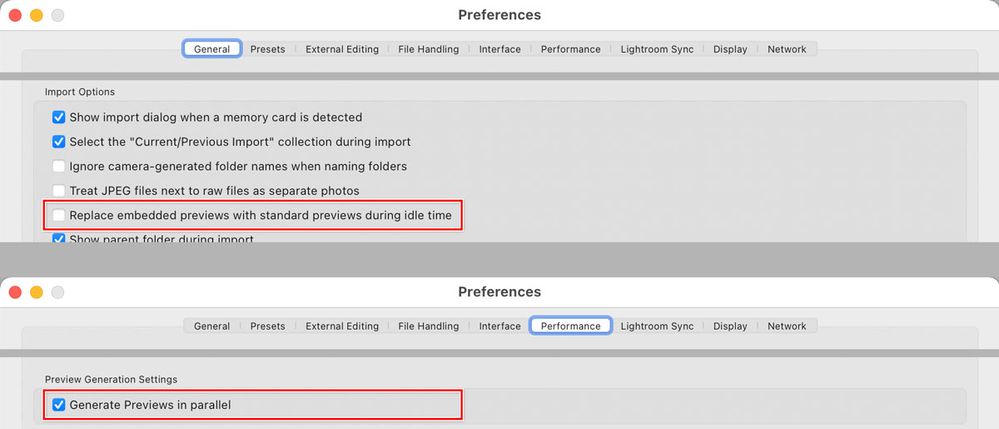

In addition to the background operations GoldingD mentioned (which you check by clicking the identity plate to drop down the background operations menu), there are a couple of preferences that also enable more background operations. When the settings highlighted below are enabled, Lightroom Classic pre-caches to enhance frame-by-frame responsiveness, by taking advantage of when a CPU has a very high number of cores (like on an M1 Max) sitting around looking for something to do. If you don’t want these to happen, disable these too.
On my M1 Pro, I generally do not see overuse of the CPU cores. Because the M1 Max has 10 CPU cores, I think 500% usage can be interpreted as using only half the total CPU capacity. (Because on macOS, 100% means the equivalent of one core in full use, and 400% would be four cores fully used.)
