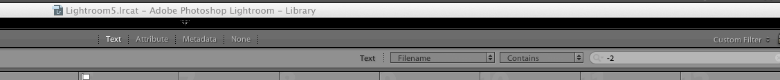

Community Beginner ,
Oct 12, 2016 Oct 12, 2016
My workflow for this:
in the Library on top select the text option and search for any images that filename contain -2 (this is the wai LR rename duplicate) then it will display all image with the -2 (duplicate)Screen Shot 2016-10-12 at 5.09.31 PM.png
