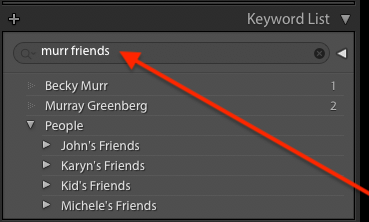

"thought I would begin to group them in a hierarchy and assign some synonyms so I don't have so many... but I have to be able to manage the list first."
As described in the links provided by WobertC, there's a couple of tricks to introducing and managing a hierarchy when you have more than 1500 keywords.
1. Keep most of the hierarchy collapsed, so that fewer than 1500 keywords are showing at any one time.
2. Enter one or more search strings in the Keyword List search box, and it will show just those keywords (and their ancestors) containing those strings:
Then you can easily drag and drop keywords to the desired parent keyword without scrolling excessively and without tripping over the 1500-keyword limit.

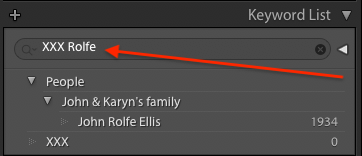

"my problem right now is that I can not even add a new parent keyword..."
What happens when you try these steps?
1. Click "+" in the Keyword List panel to create a new keyword named "XXX":
2. Type "XXX" and the name of another keyword into the Filter Keywords box of the Keyword List panel:
3. Drag the other keyword to XXX.
