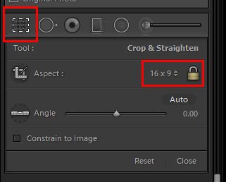

Please give this a try.
With the original image in the LR Develop module click the Crop tool icon or press the r key to bring that tool up. In the crop tool area in the right hand panel click the double triangle next to the Lock icon and where it says Original then select 16 x 9 from the list that drops down. If you don't see 16 x 9 then select Enter Custom and type in either 16 and 9 or 1920 and 1080 in the respective boxes, width & height respectively.
Here are screen shots.
Crop tool dialog. Crop tool icon and the 16 x 9 drop down in red boxes.

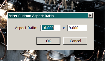

Enter Custom aspect ratio input box.
