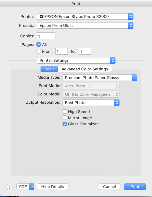

I suggest you check the obvious first: Is color being managed by LR?  Do you have the correct ICC profile for the printer/paper combination and do you have the correct media type selected in the LR print dialog AND in the printer dialog?

Thanks Joe.  First, I must have hit a 'Correct Answer' button accidentally....it is not correct.  Yes, those are the obvious and I'm good on all of those.
