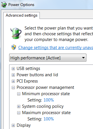

It shouldn't be necessary to disable Intel SpeedStep in the BIOS, which will reduce your battery operating time. You should be able to control this in Windows 10 Power Management.
Select 'High-Performance' mode in Windows 10 Power Management and check the 'Advanced Settings.' Make sure the Minimum and Maximum processor states are set to 100% as shown below. If not set them both to 100%, Reboot, and enable SpeedStep in the BIOS. If you still have the flicker issue I suspect your laptop has a hardware or BIOS issue. If battery run-time isn't an issue then disabling SpeedStep is a obviously a viable solution.

I dont have those settings.  Under Processor power management there is only "System cooling policy"

Apparently these settings aren't available if Virtualization is enabled in the BIOS. My processor doesn't support it so not enabled. You can disable it in the BIOS if you aren't using a virtualization app, or at least for test purposes:
Power Options - Add or Remove "Min/Max processor state"

Thanks trshaner, confirmed - I have deactivated virtualisation (whatever that does) and the settings are available.  After setting min/max to 100% and re-enabling SpeedStep the system still appears to be stable with no flickering.  As a test earlier today I had a GPU stress test (fur-something) whilst editing a 51MP image and although slightly sluggish there were no issues whatsoever.
