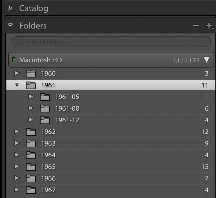

Just installed latest version of Lightroom Classic.
If I select "Show parent folder" on any folder of the catalog I get the following error message (see screenshot below). Any idea?

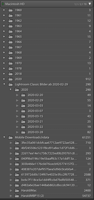

Aug 26, 2020 Aug 26, 2020
This error is often seen with the 'capitalisation problem'. The duplicate file names can also be explained by that problem. Can you post a screenshot of the rest of the folder panel?

Community Beginner ,
Johan,
please find attached the folder view in LrC and the folder structure on MacOS in finder.
Thanks for any help in advance. I never heard "capitalisation problem"...
Aug 27, 2020 Aug 27, 2020
Yes, this looks indeed like the 'capitalisation problem'. As you can see, Lightroom thinks there are two '2020' folders, one inside the 'Lightroom Classic Bilder ab 2020-02-29' and another one higher up. In reality there is only one such folder. Usually  this is fairly easy to solve, but in this case it is quite a bit more complicated, I'm afraid.
Let me first explain what the problem is. Basically, what happens is that you have two different folders, one called ‘XXXX’ and the other one called ‘xxxx’. In other words, the names are the same, except for the capitalisation. Because MacOS (and Windows too) are case-insensitive, MacOS sees those two folders as one and the same folder and so it deals with this without you even being aware of it. You only see one version in the Finder. But Lightroom is case-sensitive, so Lightroom does see two different folders. In your case it is probably that 'Lightroom Classic Bilder ab 2020-02-29' folder. That is why you get the error when you try 'Show Parent Folder'. If Lightroom tries to show the parent folder, it is suddenly confronted with the fact that there are two '2020' folders in its folder panel that are apparently one and the same folder.

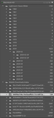

Sep 15, 2020 Sep 15, 2020
In the meantime I returned from vacation and could test your solution.
Everything worked fine and the problem is solved!!! Many thanks.
Independant of this there remains an issue with the structure of my folders.
I would love to have all my pictures in a folder structure
Lightroom Classic Bilder/YYYY/YYYY-MM/YYYY-MM-DD
like I have it now for 1709 pictures (please see appended screenshot).
Unfortunately there are 61260 pictures in Mobile Downloads.lrdata with a structure which I do not understand.
Perhaps this results from my migrations Apple Photos -> Lightroom CC Cloud version -> Lightroom Classic.
Any idea how I can reorganize this?
Yes, Mobile Data is the default location for photos downloaded from the cloud (such as photos taken with your phone, or indeed migration of other sources). You can change this location and the folder structure in Preferences - Lightroom sync. Existing downloads will have to be reorganised manually, by dragging and dropping.
