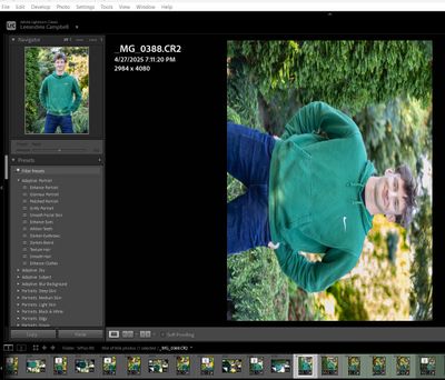

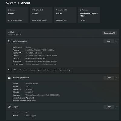

When editing images in the Develop module, images will randomly (without being directed to) rotate in the main viewing screen. I am using the most current version of LRC (v14.3.1). On a PC. Please see attached screenshot from 5.12.25 showing what is happening in the Develop module. The image has not been rotated and appears correclty in the Navigator window and the filmstrip view at the bottom. Please see second attachment for my computer specs. Since updating to version 14.3.1 a couple of days ago, this has happened to me at least 10-20 times. The only way I have been able to get the image to return to its proper orientation is to exit LR and reopen it. However, sometimes this is not correct the situation. Any suggesions or help that you can give is much appreciated. I am on a very tight deadline to complete edits of photos for my client who is a graduating senior. Thank you, Leeandrea Campbell

It just happened again when I zoomed into a photo that I wanted to edit.  I zoomed in using the Navigator window and when I did that it flipped my photo sideways and out of proportion in the main viewing area.  I'm not able to get the image back to it's correct orentation unless I exit LR and then go back in and sometimes this doesn't work.

Thanks for letting me know about that.  Here's my system info and a pic of the incident.

Thank you for sharing a screenshot of your system info. We need to know what version of your GPU driver is. May I ask you to go to Help >System Info while in Lightroom Classic? Copy and paste that into a text file and attach it to your response.
