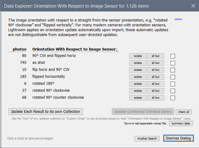

Jeffrey Friedl's Data Explorer plugin has a search for Orientation, which should work. Here's an example with some of my scanner files. I selected 'Isolate Each Result to its own Collection' and then verified the actual orientation state and they all appeared correct. Can this be also done using your AnyFilter plugin?
In this example the flipped-horizontal was done on purpose for scanning Kodak 35mm slides using a camera and macro lens. The Kodak slide mount was designed to allow some film curvature, which better matched Kodak slide projector's lens curvature of field. In my case flipping the emulsion towards the lens (reversed) provided a better match to the camera macro lens curvature of field.

Thanks John. I forgot about the new AnyFilter Filter applet. I get the same results as Jeffrey Friedel's Data Explorer plugin, but one of his orientation descriptions is incorrect.
To clear up any confusion these are all the same orientation:
EXIF Data Format = Mirror horizontal and rotate 270 CW (Edited)
Data Explorer = flip horiz and 90° CW (should be flip horiz and 90° CCW)
AnyFilter Filter = 270 degrees mirrored
I'll send Jeffrey Friedl an email so he can correct it.
