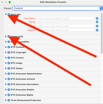

Yes, there is. Create a metadata preset where you check each field you want to remove, and keep that field empty. The caveat is that you can only remove added metadata this way, not embedded metadata like EXIF.

[This post contains formatting and embedded images that don't appear in email. View the post in your Web browser.]
Building on Johan's reply, here's a screenshot:
"It seems that we are only able to remove the data in the 9 fields identified."
There are many, many more than 9 fields. Make sure you're expanding each group by clicking the triangles to the left:
