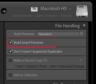

Check that you've checked the 'Build smart previews' box in the Import module (see atatched screenshot for location). If the box is checked, then your LrC preferences may be corrupt. You can reset these by following the steps set out in Method 1 at https://helpx.adobe.com/lightroom-classic/help/setting-preferences-lightroom.html

Thanks for your reply Ian. I did check and Build Smart Previews is checked. What started this was a few imports ago I received a message saying that smart previews would not be built. This was half way through the import. Ever since then I notice that as the imports load-I usually import about a thousand 45 MP  images from my Z9 card, that I see that LrC is only building standard previews with no mention of Smart Previews. So I assume that they are not getting built. I don't know how to check If someone does please advise, I would appreciate it.
