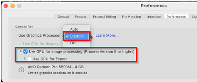

@manzurfahim Yes, there's a workaround.
Goto the preferences and set the option Use Graphic Processor to Custom. Then you can disable the GPU usage for export.

Thank you for the reply. But this is my setting. Custom and GPU export off. But it does not work. It exports one or two files, then the catalog stops responding. Only when I set it to Auto, or enable GPU export, then it works.
I tried upgrading drivers, rebooting the system. Same issue.

Intel GPU was already disabled. Studio drivers didn't help either.
But I managed to fix the issue. NVIDIA GPUs were having some black screen issues with the latest drivers, so I uninstalled the new driver series (572.xx), and went back to 566.xx version. Fixed the issue. No more problems exporting with CPU.
