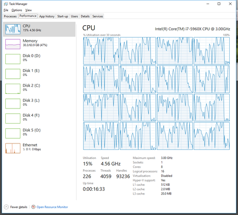

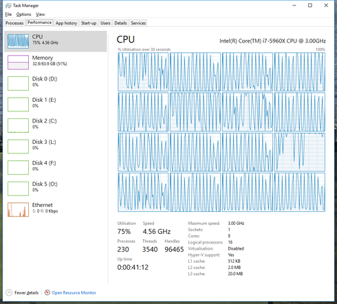

here are the CPU graphs
1. first run CPU maxed to 100% most of the time
2. second export CPU less busy export is slower
3. third export CPU even less busy and export is even slower
4. forth export even slower, I skipped the screenshot you got the idea ...
4. forth export even slower, I the screenshot you got the idea ...
