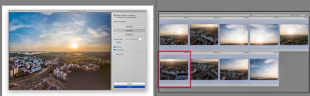

I have encountered this issue earlier but didn't bother to do anything about it, but now I just have to.
Issue: As visible in the photo below, you can see that the lower right hand corner is just a black area. For some reason the base photo is not being taken into account when merging.
Is there a fix?

Hmm, black aas opposed to the screen color.
Look at the bracket of photos, was that area covered? As in did that corner get photographed?
Was this a multi row bracket? do the images surrounding that corner shot have sufficient overlap? (some say 1/4, some say 30%)

After the merge,what do you get? Is that corner just under exposed?

Hi and thanks for taking your time reading about my issue.
The shots come directly from DJI Mavic's panorama (9 photos option) function. So far DJI's panorama function has done a pretty decent job, it's only maybe a handful of times that I get those black areas. The area is dark, granted, but not really underexposed in the sense that it couldn't be read by LrC.
I took a screen capture video of the process, this could help illustrate the case.
LrC merge issue clip

Please post a screenshot of the LrC Library module Grid view showing all 9 image files for comparison of relative exposure.

thank you for your interest in this case. Below is the screen shot.
NB! In the mean time I have tried out LrC merge with different settings and other panorama sets and noticed that the same issue prevails when using 9 photos, but when using a panorama with 21 shots there is no more blacked out area in the lower right hand corner.

I adjusted the exposure of your screenshots in LrC to reveal the shadow detail and the lower right-hand corner is fully covered by file PANO0006. I can see no reason for the panorama stitching failure. If you can upload the below nine PANO DNG files to Dropbox I'll take a look at it and see if we need to create a problem report. As a quick test try using the same nine DNG files with Photo> Edit In> Merge to Panorama in Photoshop and see if that works.
