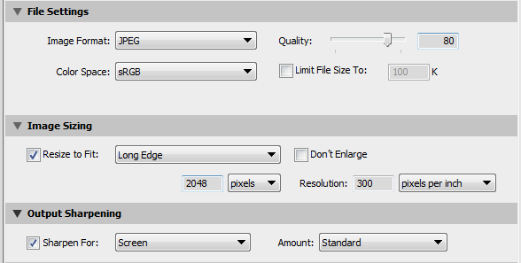

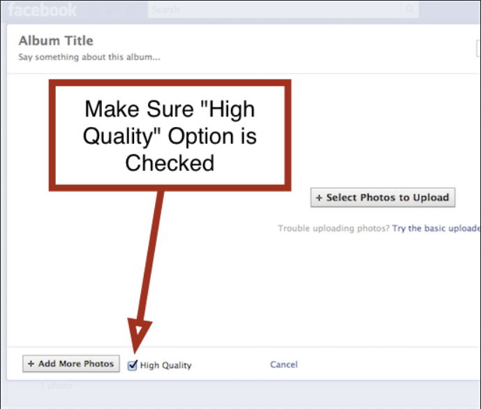

It looks like FB is compressing the uploaded image file perhaps because it exceeds the maximum file size (MB). Try using the below Export module settings with 80 Quality and then upload the file to a separate FB photo album. Also keep in mind that some people have their display brightness set way too high, which make artifacts more visible.
Forgot to add that you need to make sure 'High Quality' is checked when you create the new FB album.

I believe it does upload to high quality.  I uploaded it outside of an album, just a single photo, but I'll do some test uploads and set to "Only Me" to check it out.  Also, I don't check anything under the sharpen portion, but I noticed your screen shot reply showed that checked.  I read in another forum to not mess with that.  In this case, does that matter?

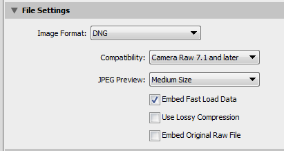

Make sure you have all the same LR settings applied before exporting the NEF to DNG file format. This will help with the evaluation and possible solution.

Well no DNG file posted with your edits so I gave the NEF file a try.
Using +25 Clarity and +35 Dehaze along with Basic Tone and some HSL adjustments I was able to achieve similar rendering. Note that I unchecked 'Enable Profile Corrections' to keep the Sky gradient-range as large as possible (i.e. no vignetting correction applied). Exporting the adjusted NEF to 2048 px sRGB JPEG with various Quality settings shows no banding until Quality level 35. I uploaded a 2048 px sRGB JPEG with Quality 100 to Facebook and no banding is visible on my NEC 272w or HP 2509m monitors. I downloaded the Facebook photo and it's about the same size as the 50 Quality JEPG export (see below) so it looks like Facebook is using some aggressive file compression even on 2048 px images. You can download the files at the below Dropbox link. The DNG file has my edits applied for your review.
