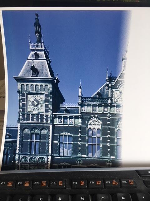

Having followed as much as I could with links and profiles, I tried another print.
What I wanted.
What I got.

Like I said: if you don't have a printer profile and this is what Lightroom does with 'Printer Manages Color', then you probably can't print from Lightroom with this printer. Export your image as JPEG and print it in some other application.
