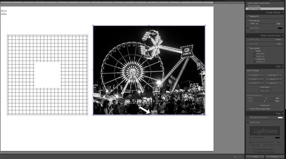

Thank you for your patience everyone! I have included a very simple layout here that illustrates the issue. Interestingly the square grid I dropped in doesn't seem to suffer from this cropping, however my images that are not square, 8x10 12x18, etc do. It appears to be the long edges that have the crop (both sides). In the screen grabs below I put in arrow showing the most obvious area of concern. In regards to the "match photo aspect ratio", I have tried that and not seen a difference in behavior.  I apologize for not creating this document before as it would have been clearer. layhout1.jpglayhout2.jpg

Looks like you make a common mistake. If your cell is say 8x10 and you drop in a photo that is 8x10, then the photo fills the cell quite nicely. If you then try to add a border of say 1 inch, then the photo does not fit in quite nicely anymore and so it gets cropped. The reason is that ading the border changes the aspect ratio: 6x8 (8x10 minus a 1 inch inside border) is not the same ratio as 8x10. The cells in the custom package are freely resizable, so it's always possible to have a uncropped image with a border, but you may have to change the aspect ratio of a cell to achieve that.

It appears the 'Lock to Photo Aspect Ratio' is calculated with the Photo Border applied. You don't see the issue with square images because the added border is still 1:1 aspect ratio. This was reported 8 years ago at the below Photoshop Family post. You can add your 'Me To Vote,' Follow,' and any comments. Include a link to this post "for more information."

Example for calculating proper cell dimension for an 8x10 aspect ratio landscape image with 36 pt (.5") border.
Cell Height = (Desired Cell Width -2x .5" Border) (8/10) + 2 x .5" Border =8.2" for your example
Cell Width = (Desired Cell Height -2x .5" Border) (10/8) + 2 x .5" Border = 9.75" for your example
Or simply adjust the Cell Height or Width slider until there is no cropping. Of course this begs the question as to why you would want to make "odd size" prints, such as 8.2" x 10" or 8.0" x 9.75"? A good answer to this question will help to justify your case for a change. At the very least it would be nice if you could reposition the crop instead of simply centered.
