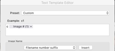

Can I ask how have you customised the Photo Info menu?
What task have you set the software to perform there?
Explorer ,
Dec 07, 2019 Dec 07, 2019
Hi Tony
This would give the ordinal number of the photo within the contact sheet preceded by the constant "c" for colour.  Thus, c12 would mean the 12th photo in the (colour) contact sheet.
