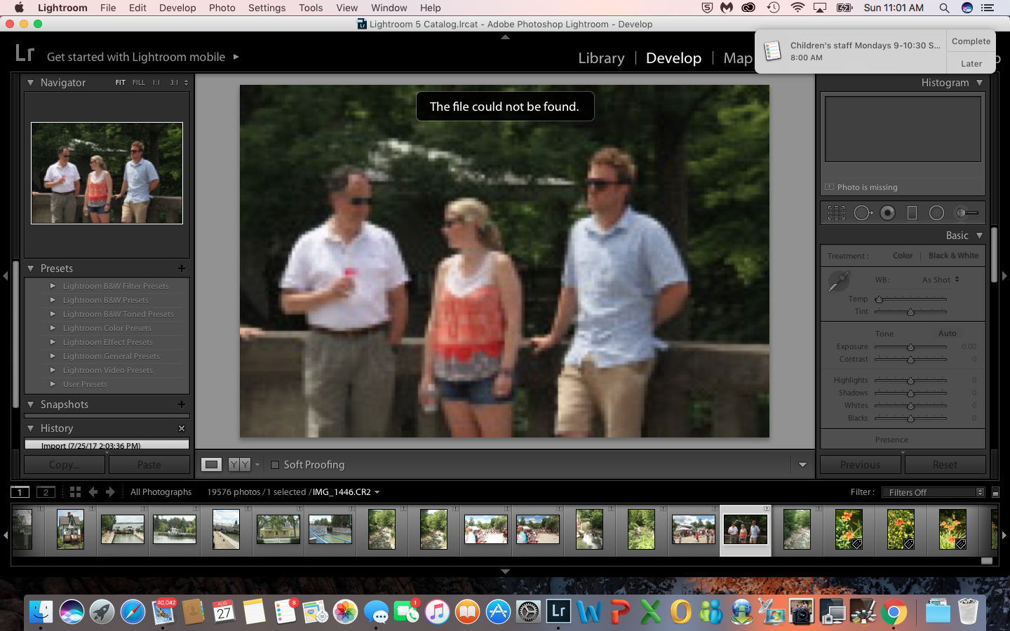

Here is the screen shot to give you an example of what I am seeing with the notation of "file could not be found"... If the issue is I need to merge- I will try to do as you suggest and merge the two- I do keep back ups...Thanks...

I see the screen capture ... the File Cannot Be Found message is the key piece of information. You need to first find these files using Windows Explorer or Mac Finder. Do you know the exact folder name where these photos are located?

Please search for this file by file name. Use your operating system's search feature to search all disks for file(s) with this file's name.
Do you have backups of these photos?

Thanks, Will do. I have backed up all of my previous pictures/computer and will look to see what I can do to retrieve off my back up hard drive- thank you for the input. I just thought since the pictures seemed to be showing in the photo strip in Lightroom, that they were there, some how but now realizing there is more missing from prior to my computer problem and will work now to try and restore all those other things as well.
Aug 27, 2017 Aug 27, 2017
You should be aware, that Lightroom dos not take the pictures and store them in the database. Import means only that either LR learns about where to find the image file or that the image file is copied where specified in your file system structure. If you delete thise files or move them outside of Lightroom to a new destination, LR has no possibility to know where to find the file. This is basically what you're experiencing.
LR can reattach the file to his database, if you can tell LR where the file is located. Best would be, however, to copy or move the files to theis original location and move them where you want to have them using the file manipulation tools of LR.
