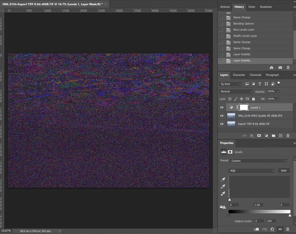

Open the two files in PS as layers, set one to Difference Blending, add a Levels Adjustment Layer, and set the White slider below the Levels Histogram all the way to the left (2 level). Here's an example using TIFF 8bit sRGB and JPEG 80 Quality sRGB export files. Even an image with only one pixel different is visble.
