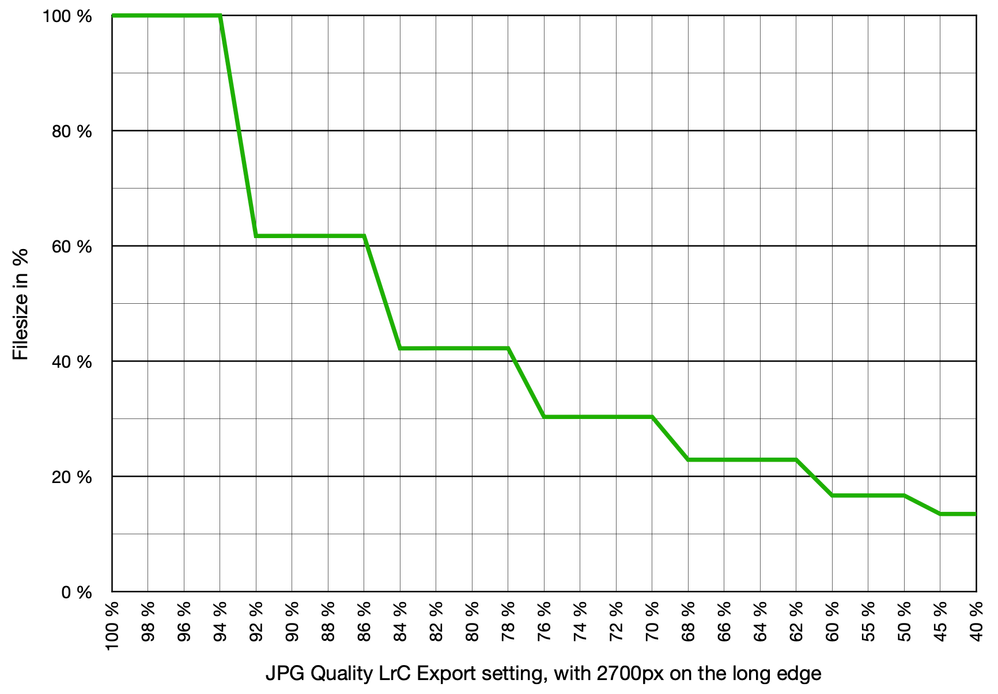

I did once a small study.
I took 100 photos, different subjects and exported them from Lightroom Classic 11.x
Base photos were DNG, converted from CR2 (Canon 5D Mark IV).
All other settings were identical, I only changed JPG quality.
The result: The JPG quality does not correlate 1:1 to the final filesize of the exported JPGs.
