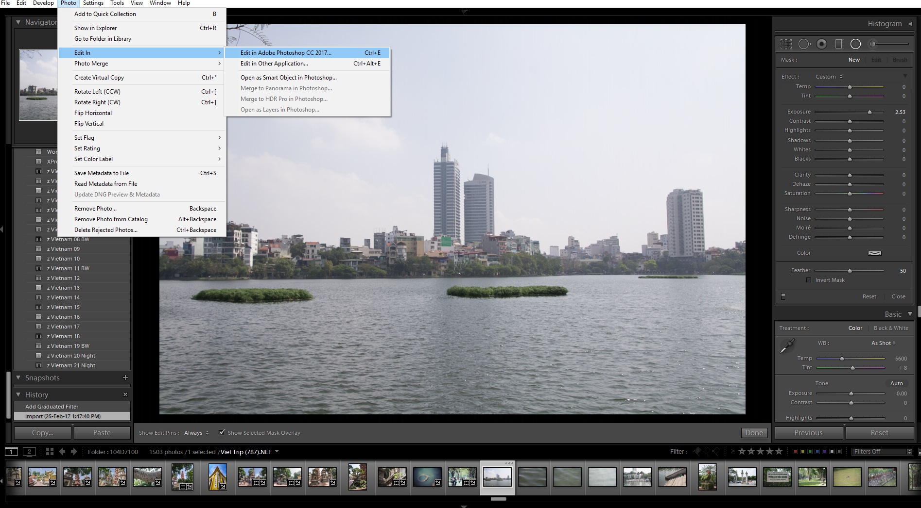

It was working fine then suddenly not. After several hours of processing my photos in Lightroom, there was suddenly a change in where the edited photo was placed in my stream after editing in PS. Initially the edited version was placed next to the original image in the stream, but then for some reason it started to place the edited photo right at the end of the stream. I had online help with me for an hour, even accessing remotely to work on the problem, but nothing worked. They will escalate the issue and hopefully get back to me. If doesn't matter if I check or uncheck to keep the stacking with the original raw file, if checked to keep together, then they both go to the end of the stream. It's very annoying to find where you were up to when you have a lot of photos in the stream. Any ideas anyone?

The order of the filmstrip is the same as that set for Library grid view.  You've probably accidentally changed the sort order.
Go to Library and do View > Sort > Capture Time or > Filename.  (You can also set the sort order via the toolbar, but it's easier to explain using menus.)

Thank you my friend, that solved the problem. You're better than the tech guys online lol. Thanks again. It was really annoying me.

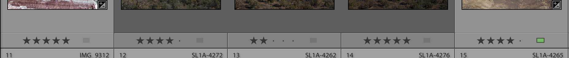

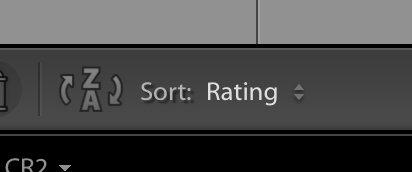

The three middle photos are stacked and the sort method is by RATING.  As you can see, the photo in the stack do not honor the sort.  Having the stacked photos move all over the grid during a sort defeats the purpose of a stack.

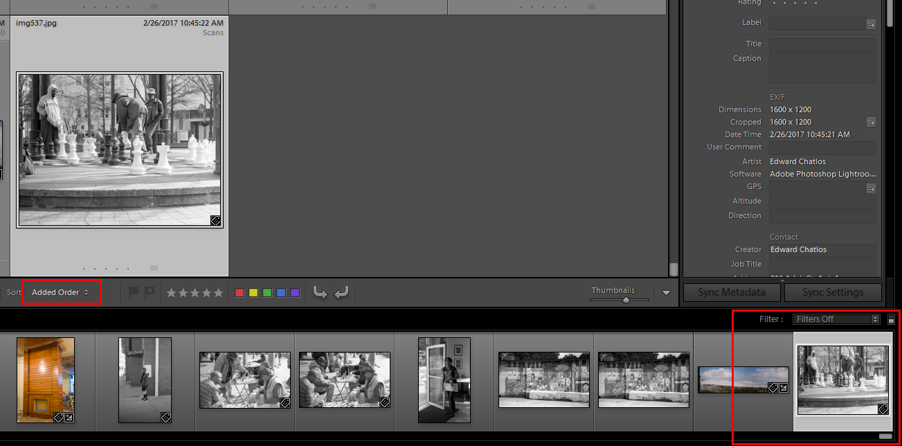

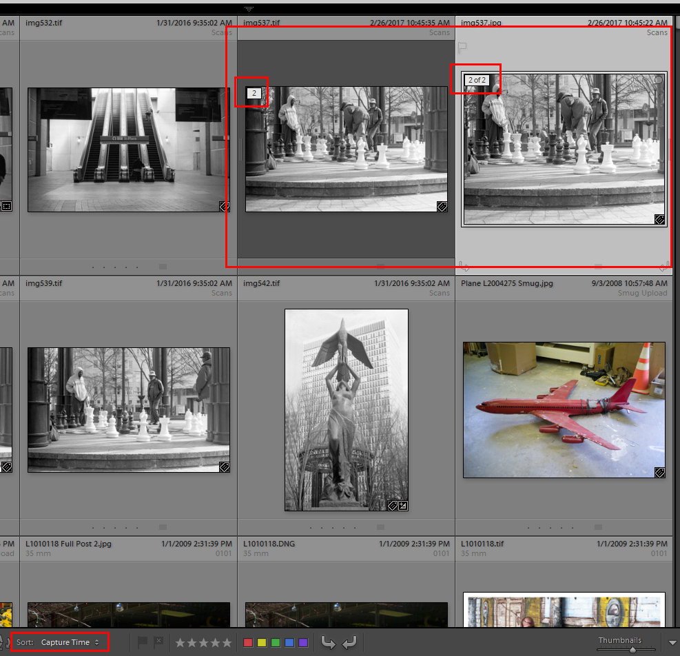

Ok so? If they are stacked then they appear together. Your other post you said if they are Un-Stacked they still appear together no matter what the Sort is set to and that is not correct.
Then that stack unstacked and sort set to Added Order. You'll note the image is now at the end of the film strip and the last image in the grid view.
Now I have to Re-Stack them.
