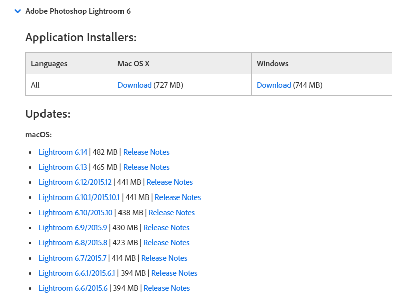

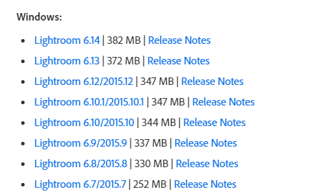

Right the Cloud App, the CC DTA, should show you any updates if you are using the perpetual license version LR 6.
Go to this page and download the Update LR 6.14.
Download Photoshop Lightroom
