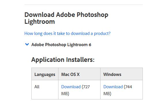

Nov 29, 2016 Nov 29, 2016
You need to download the Lightroom 6 application installer and install from that file.

dj_paige - it looks like the image you posted on the thread above is a screen snapshop and I cannot find any definitive link in the adobe image bank that relates to this. I have found a few but they only provide me with upgrade versions of lightroom to something that is already installed.
