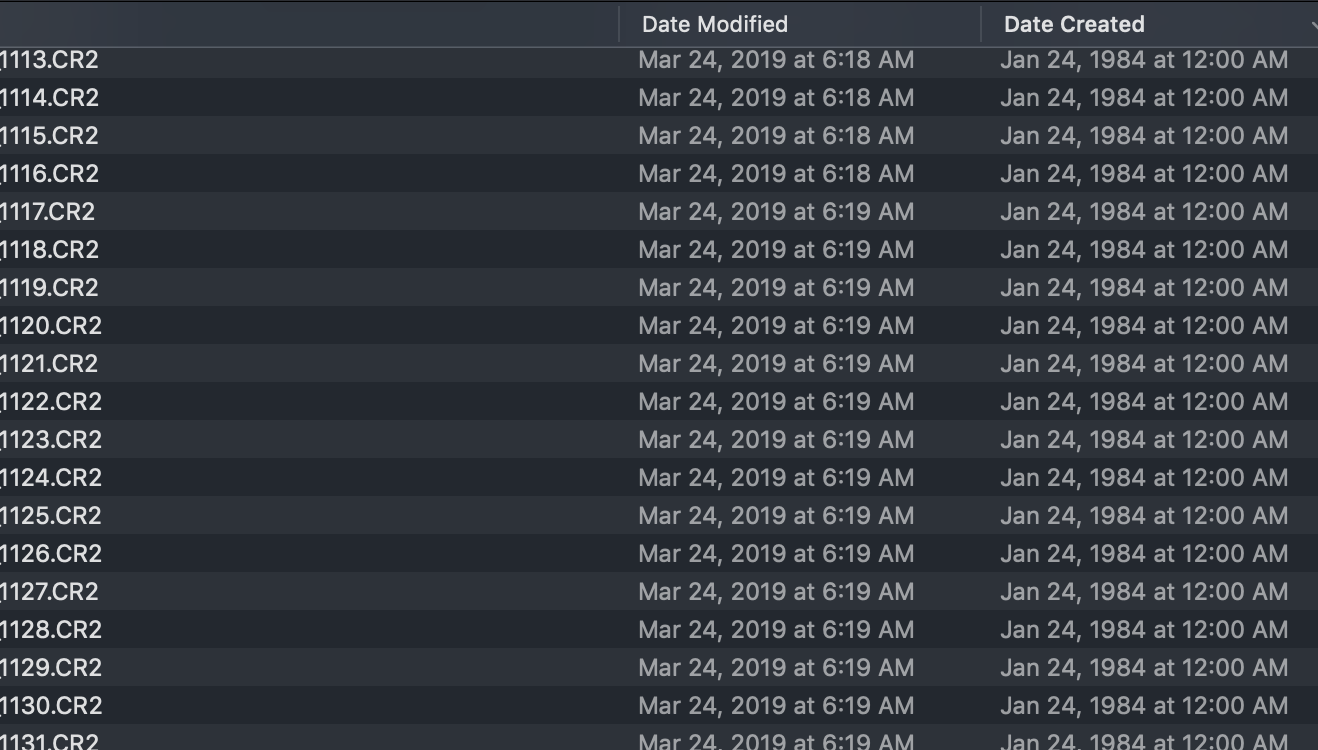

When viewing the files via LR, it reads the creation date correctly.  But when accessing the files via finder in osx when I'm backing up the job, the creation date has changed to 1/24/1984.
I also kept a copy of the original downloads in another folder and the creation date reads properly there, even on the back ups.  Its just some (NOT ALL) of the renamed files that the creation date changes in the finder only not in LR.

Yes I'm referring to the date created in the finder.

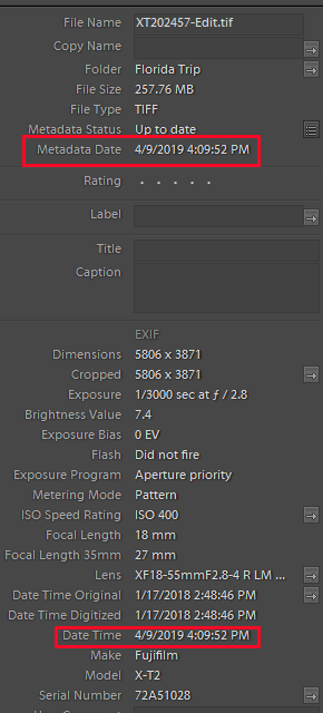

That date in Finder is when the File was created or changed On the Hard Drive. The OS File manager knows nothing about the Digital Image creation date and time, the date and time the image was taken.
This is totally normal and you may even see the Metadata date change in LR.
