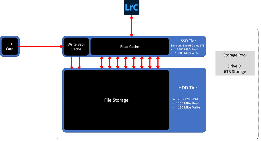

Here is a diagram that describes it:
My 6TB drive which normally reads at 150MB/s and writes at 130MB/s now has a couple of caches in front of it:
  • Write Back Cache.  This is used for when writing photos/videos to the drive.  In my case I've configured it with 1/10th of the size of my NVME drive - 100MB.  Now when I write photos/videos to my storage drive, it writes them at 3200MB/s!  Each night (its weekly by default) Windows will run optimization at 1am and offload the write back cache - ready for the next job.
  • Read Cache.  The remainder of my 1TB NVME is configured as a Read Cache.  Windows maintains a "Heat Map" that marks which files are accessed the most - these are mirrored into the Read Cache everytime the Optimizer runs.  This means that often accessed photos/videos will be read at 3500MB/s instead of at 150MB/s.
