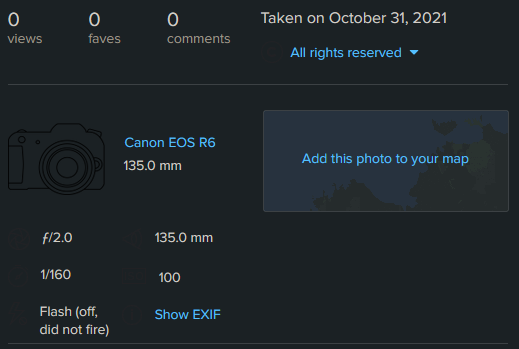

Ever since I got my Canon R6, Flickr won't display lens information in case 3rd party lenses (in this case Zeiss) are attached. I see this:

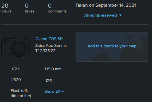

while I see this on Flickr when the picture was taken with a Canon 6D:

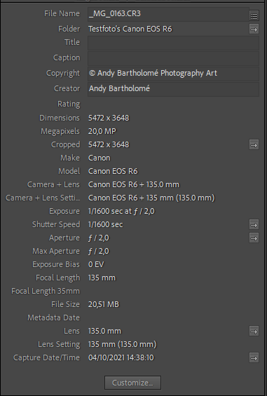

Flickr only shows what is present in the file, so I checked Lightroom, and I see that in case of 3rd party lenses (in this case a 135 apo sonnar) that no lensmaker info is shown in Lightroom, only the focal length on the R6:

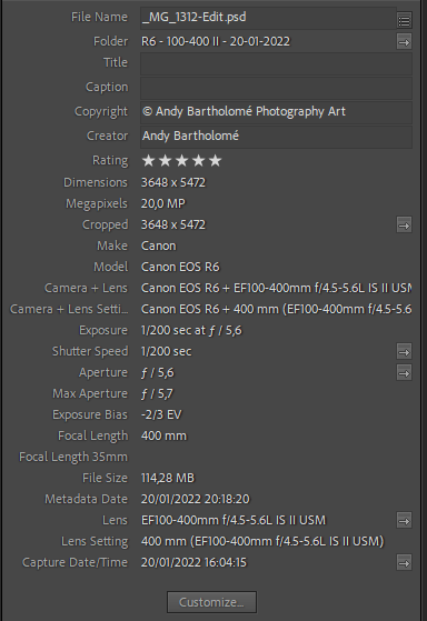

When I attach Canon lenses (16-35, 70-200, 100-400 etc) to the R6, it works fine:
Flickr:
Lightroom:
So I don't think creating a ticket at Flickr makes sense, since it is already missing in the Lightroom library.
After that, I thought it was Adobe reading the wrong metadata fields from the camera, but I have been using LR for ages, and it doesn't matter which version of LR I use (of course I always keep it up to date), because I don't have this problem when using the 6D.
So the camera seems the only common denominator. I use firmware 1.4.0 on the R6 due to the AF-issues in later versions (hesitant to try 1.6.0). My guess is that Canon does not fill the proper metadata fields in-camera in case of 3rd party lenses. It works perfectly fine when a Canon lens is attached, so the camera does fill metadata fields.

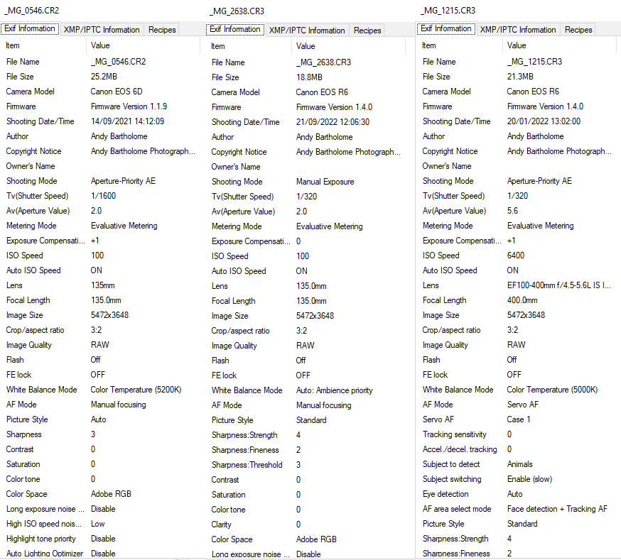

In DPP4 it even does not show Zeiss lensinfo with the 6D, while in Lightroom or Flickr it does show Zeiss lensinfo...
Left: 6D + Zeiss 135 apo sonnar (on Flickr and Lightroom show the correct lensinfo)
Middle: R6 + 135 apo sonnar
Right: R6 + EF-100-400 II

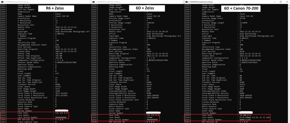

I hope you have some insights. I've executed exif tool and looked at the EXIF-tags and I see:
When I check the MakersNotes and Composite, I see multiple tags:
- Lens Type (2 occurences)
- Lens Info
- Lens Model (2 occurences)
- Lens ID
R6 + Zeiss (_MG_3306.CR3):
  • Lens Type: 33 (twice)
  • Lens Info: 135 135 0 0
  • Lens Model: not filled in (twice)
  • Lens ID: 33
6D + Zeiss (_MG_3309.CR2):
  • Lens Type: 33, 0
  • Lens Model: 135mm (twice)
  • Lens ID: 33
R6 + Canon 70-200 (_MG_3307.CR3):
  • Lens Type: 251 (twice)
  • Lens Info: 70 200 0 0
  • Lens Model: EF70-200mm f/2.8L IS II USM (twice)
  • Lens ID: 251
6D + Canon 70-200 (_MG_3308.CR3):
  • Lens Type: 251, 0
  • Lens ID: 251
The case that is most curious is that of 6D + Zeiss (_IMG_3309.CR2), because that one shows the correct lensidentification in both Lightroom and Flickr while the Lens Model-tags in EXIFTOOL does not indicate that it is Zeiss 135 APO SONNAR....
I have this data, but I don't know what further to conclude...
