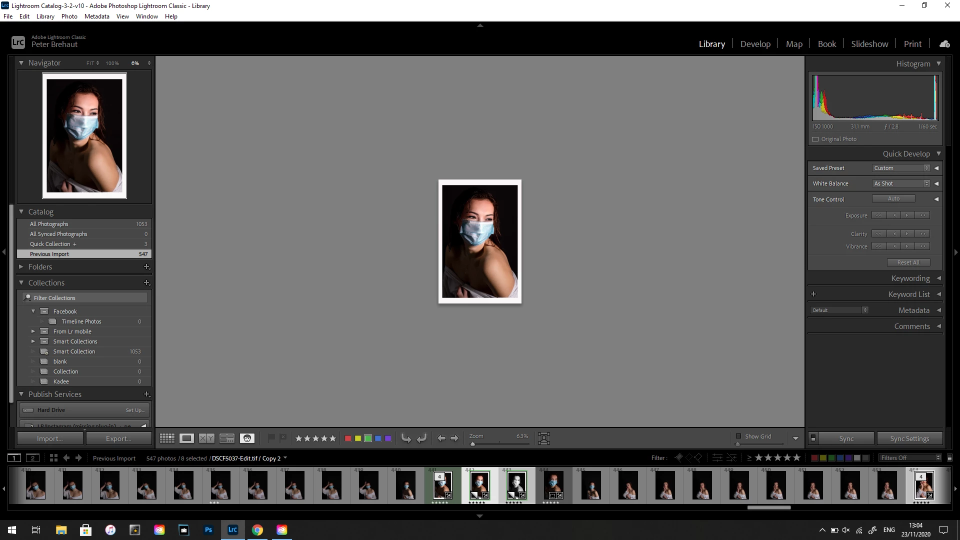

I am having a problem with the zoom slider in Lr classic. It seems to be set to 6% which shows a small image on screen ? I have to select "Fit" to have the image zoomed out to normal size. This is not how it would work in the past so any help would be great 🙂

From your Screen Shot you have 2 images selected in the filmstrip. You also have the slider set to 6.3 %. If you change the Loupe displayed image with the slider set to that 6.3% the new Main Selectd image will show at that Zoom. Set it to Fit and then change the image. Does the new Selected image FIT the screen?
If this does not happen then the first thing you should try is turning off the GPU option in the LrC Perferences on the Performance tab.

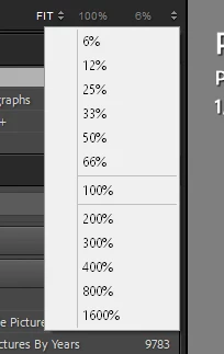

Thanks for that 🙂 It seems to work better now but how do I set the zoom slider back to zero and it will not go lower then 6% .
Peter
Just Shoot Me
November 23, 2020
You can't set the slider at zero. Why Would you want to do that?
Zero would Not show the image.
Look in the left hand side panel at the top for Zoom Options.
